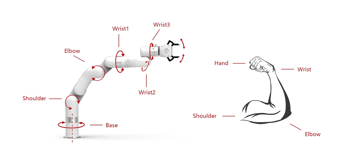

Different Joints of Robot Arm
The structural plan of the typical robot arm consists of seven segments and six joints. This structural framework makes it very similar to the human arm though its shoulder is connected to a stationary base. Also, it allows it to exhibit a range of movements. While the human arm permits movement in seven planes, the typical robot arm permits movement in six planes. The segments and joints of a robot arm interact to produce movements. At each joint, motors are installed. The computer moves the robot arm by rotating the motors. The movement of motors is in discrete steps producing more precise movements which are reproducible.

What Are The Parts Of A Robotic Arm?
The different parts of a robotic arm are arranged to make it resemble a human arm, having a shoulder, elbow and wrist. A typical robot arm contains two parts, one is the arm (manipulator), another is the controller (motion planning system).

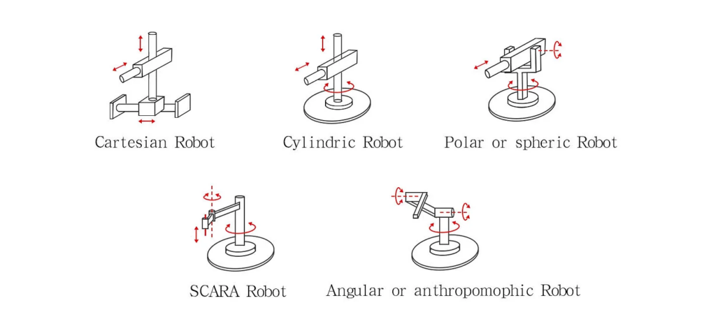

Different Types of Robotic Arms
Different Types of Robot Arms
There are different types of robotic arms. Each with its peculiar structure and applications. The differences that exist between the different types border on their unique articulations, range of movements and functionality. The types of robotic arms include:
Cartesian Robotic Arms
The mechanism of operation of these robots is based on the Cartesian coordinate system (x, y, and z). They are also called rectilinear robots. Cartesian robot arms allow movements in three planes. They consist of three articulating joints which are programmed to coordinate movement along three axes. This makes them more accurate and simpler to operate. The actuators help to manipulate an object through sequential linear movements, effectively switching between positions. One actuator moves left to right on the x-axis, another actuator moves upward and downward on the y-axis, while the last actuator slides forward and backward along the z-axis. A Cartesian robotic arm can be placed horizontally, overhead or vertically.
A Cartesian robotic has three axes. Repeatability of 0.01mm to 0.34mm. A minimum payload of 100Kg and a maximum payload of 250Kg. Its average speed is 1200mm/s

Cylindrical Robotic Arm
A Cylindrical Robotic Arm has three axes. A Repeatability of 0.1mm to 0.5mm. A minimum payload of 5Kg and a maximum payload of 250 Kg. Its average speed is 1000mm/s.

SCARA
The word SCARA is an acronym for Selective Compliance Articulated Robotic Arm. These are robotic arms that contain two parallel rotatory joints. Though they are faster than Cartesian robots, Cartesian robotic arms have more precision. They move swiftly on all three axes and are best suited for lateral movements.

Spherical or Polar Robotic Arms
The basic plan of these robots consists of an arm connected to a linear joint and two rotatory joints. Movements are along polar coordinates bringing about a spherical motion sequence. In a polar configuration, a linear joint is placed above or below a rotatory joint, and a rotating base supports these joints.

Angular Robotic Arms
They are also called anthropomorphic arms. They are very identical to the human arm. Angular robotic arms are fitted with fingers and opposable thumbs. They are versatile and can be utilized for different functions.
